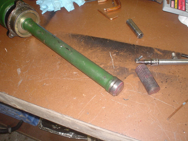

When my passenger side axle broke, I was able to drive the car a few blocks to my house, since some of the power was transferred to the driver side via the stock LSD, but I had to be extremely gentle with the gas pedal.
I'd be curious to see what happens if you put the car up in the air, and run it through the gears (engine running of course).

Crappe. That pic is exactly what I had mind, only driver's side. Break right at the end of the splines. When I fracked up my pass axle I was able to nurse the car down to shop for replacement but it was obvious I had little power, about 2-3 months ago. I think you just confirmed with the stock LSD if the driver's side axle breaks in the same place or manner, you'll get NO power?
I don't know how it could break, all I was doing was quick-shifting at 7000 rpm through 1-2-3 a few minutes before it broke, and running weekly autox before that...go figure
If I pull the wheel and try to move the axle out/in then I expect a break like that is going to be obvious - slop.
