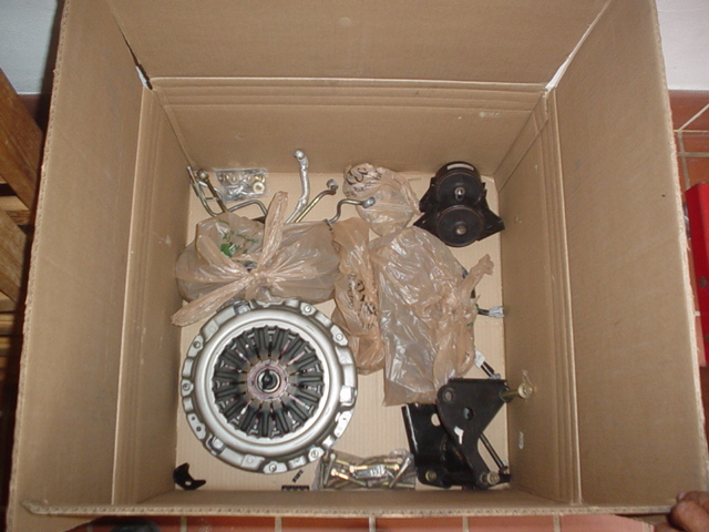

Old 03-24-2007, 05:30 PM   #219 (permalink)
Jah Rastafari
Location: Miami, Florida
Feedback Score: 61 reviews
Originally Posted by SENTRASER View Post
So where's pics of the flywheel?? Anyone got one yet?
The Flywheel is under the clutch in this pic you can see the clutch has the bolts bolted onto the flywheel.
It is a 250 mm clutch and flywheel setup. Stock is 215 mm.
Andreas Miko is offline   Reply With Quote
