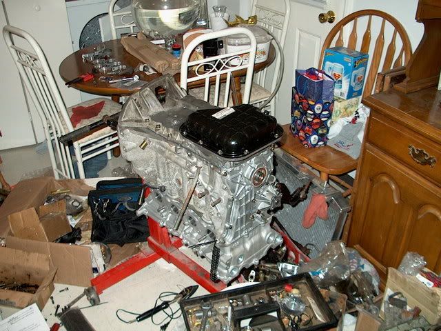

progress pics..........
i been findin time at about 1-3am on the weekends!!!
get it where i can. i wanna boost already dammit!

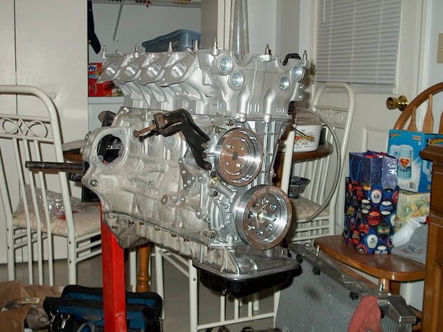

oil pans on, pulleys mocked up just for looks!
waiting on 2 HLA to button up the head.
Old 04-28-2008, 09:37 PM   #85 (permalink)
wow, i resized the pics, much better!
dammit, now looking at them, i gotta clean that block a little better.
now thats a money shot.....in the kitchen!!!

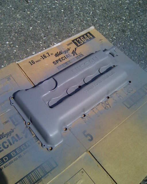

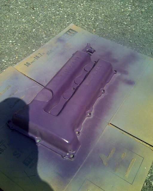

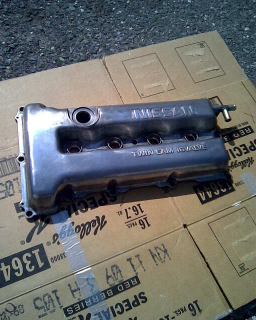

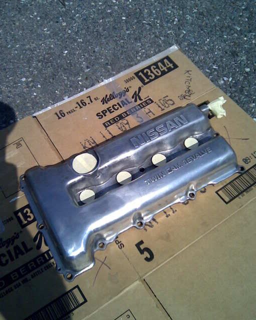

Old 05-01-2008, 01:26 PM   #88 (permalink)

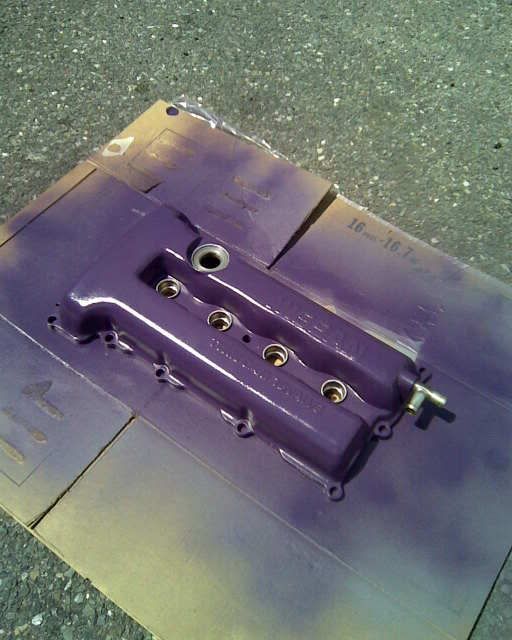

was gonna go polished, but *** it
its not perfect, but the prep was and it aint commin off!
its called plum purple by plasi-kote. it's engine enamel with the ceramic shyt in it. i am going to sand the letters when its fully cured. wish i had taped them, but oh well
EDIT: mocked up with the digi-cam

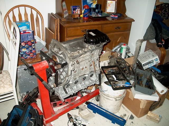

ended up taking the pans off, loosening and re-torqueing the main studs.
all seems well now. im clueless as to how they got so tight, as they were good before the pans went on. but whatever.....i learn as i go right?!!

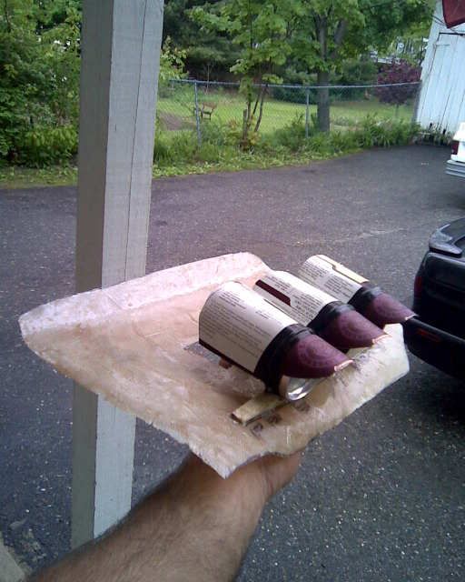

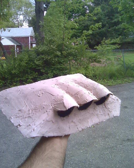

Old 05-20-2008, 10:13 PM   #94 (permalink)

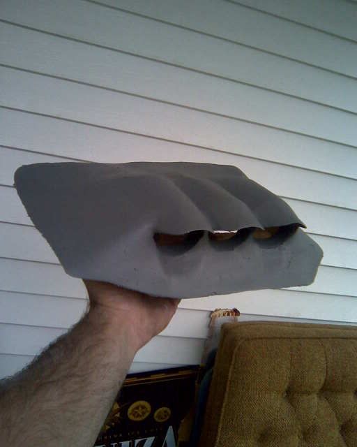

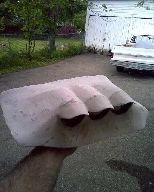

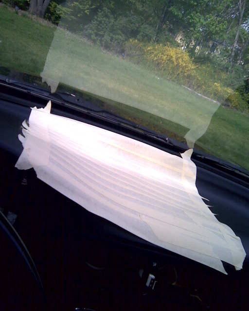

the beggining of my custom guage pod for the dash......
i whiddled grooves in the wood for the bezels to sit in.
varied heights and epoxied solid at an angle towards the driver
some turbo cups from dunkin donuts for visors, and a graham cracker box for protection:
word to the wise, when it says use outside or in a well ventilated area.....they mean it!!! my head is mushy!!!

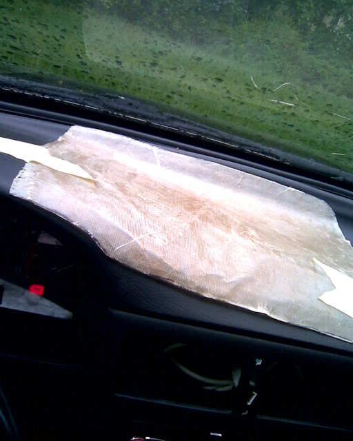

i forgot to snap off a pics complete with all the fiberglass on and trimmed.
i will post the pic of it all bondoed when it comes through the email. my batteries are dead again for the digi. i hate that thing!!!
time to sand sand sand! i will paint today!!!

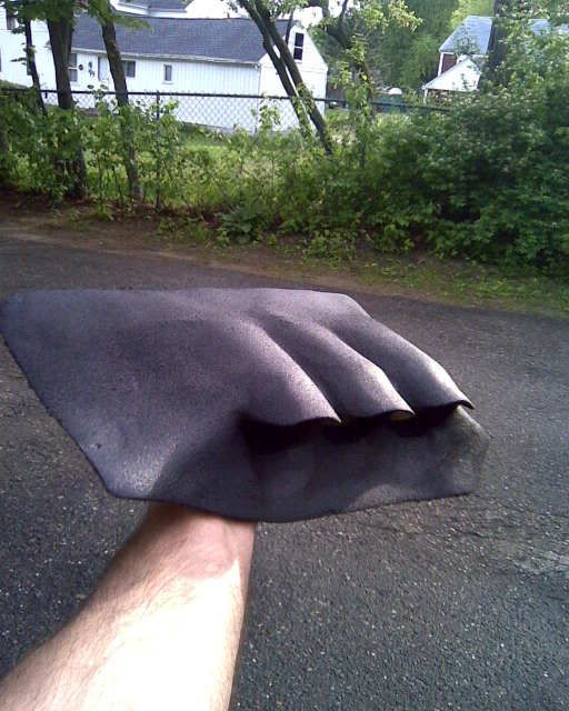

i HATE sanding! 80 grit, by no means perfect. i will use the bed liner spray on stuff which will hide any imperfections that i left behind.
primed....the pic makes it look like hell. it really looks better than that!
one more pic to go....just gotta go buy the bedliner stuff

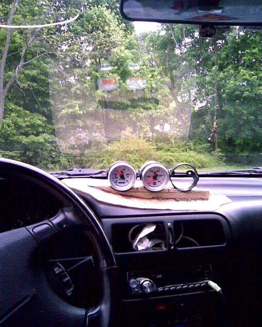

finished product:
im going to run a trim piece around it. by no means perfect, it coulda been, but i am satisfied with the results!!!
installed pics maybe this weekend

Looking good thus far. 1 question though......... WHy didn't u angle the guages towards the driver(you) for better visibility?!?!?

i did
