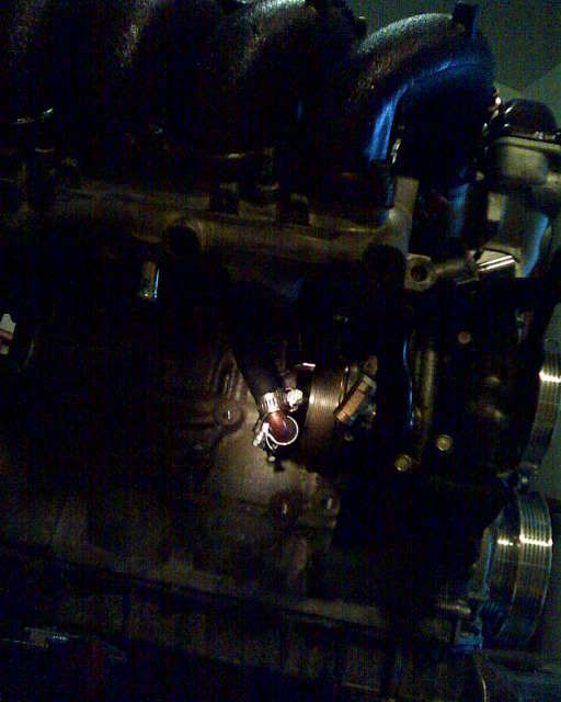

thanks mike. yea, was gonna be purple and grey, but is winding up more purple than grey....lol
it's the H20 piping that i am having issues with. i obviously have a perfect map on the motor in my car, but cannot see what i need to see with it all tucked away under and behind everything.
any and all pics will be greatly useful though i am sure!!!
i only threaded in the oil pressure switch today, but it is more than i had done yesterday. get crackin on your build...one switch at a time and it'll be done soon enough!!!

Old 06-09-2008, 11:38 PM   #111 (permalink)
ah dude, no apologies needed.... big-ups for the effort!!! MADD appreciated!!!
i think i have figured out the the routing all but two nipples. they are different sizes and have concluded one is coolant feed for the turbo, and the other is vac for the waste gate.
my last issue is all the damn conflicting info i find on restrictor size for the turbo. i am going to call atp tomorrow to bounce ideas. i need to figure this out and get lines made or configured to swap this weekend and next week!!! next week is my paid va-ca and projected finish/swap date!
EDIT: atp said a -3 restrictor is needed

Old 06-14-2008, 12:19 PM   #112 (permalink)
woot woot.....my motor is done!!!
next week i am on va-ca from work, great timing!!!
i will be starting the swap on tuesday. a spot is reserved at my boys house in the barn. it is so on!!!!!!!
i still gotta figure out a few quirks, but whatev!
next time i post up will probably be saying it either was a success, or failure
