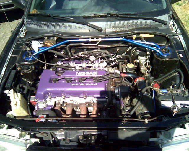

the mad scientist at work.....
initial fire:
first run...captain nathan at the helm, lookout ann!!!
this before we noticed it leaking...

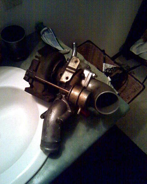

so, i hadnt yet disclosed this information....but the crappy header had to get bolted onto the motor. this comes as a result of my turbo inexperience.
the car became real choppy, breaking up and stalling last night. i just figured the tune needed to be gone over again since my boy had to write a hole new map as a result of no turbo.
we concluded it was a bad injector in cylinder #1.
i come into this turbo game with little understanding. i come out with a whole lot of knowlegde and a successful build. as we all can see, i have been at it for well over two years now. if we compare posts from feb '06 to now, and see that i have a running motor, we can conclude that i have become alot more knowledgable.
i learn as i go, typically the hard way which always seems to result in a loss of $$$ from my wallet!
WHATEVER!!!
so my 8.5:1 built NA sr20 sentra is parked untill i aquire new injectors.
