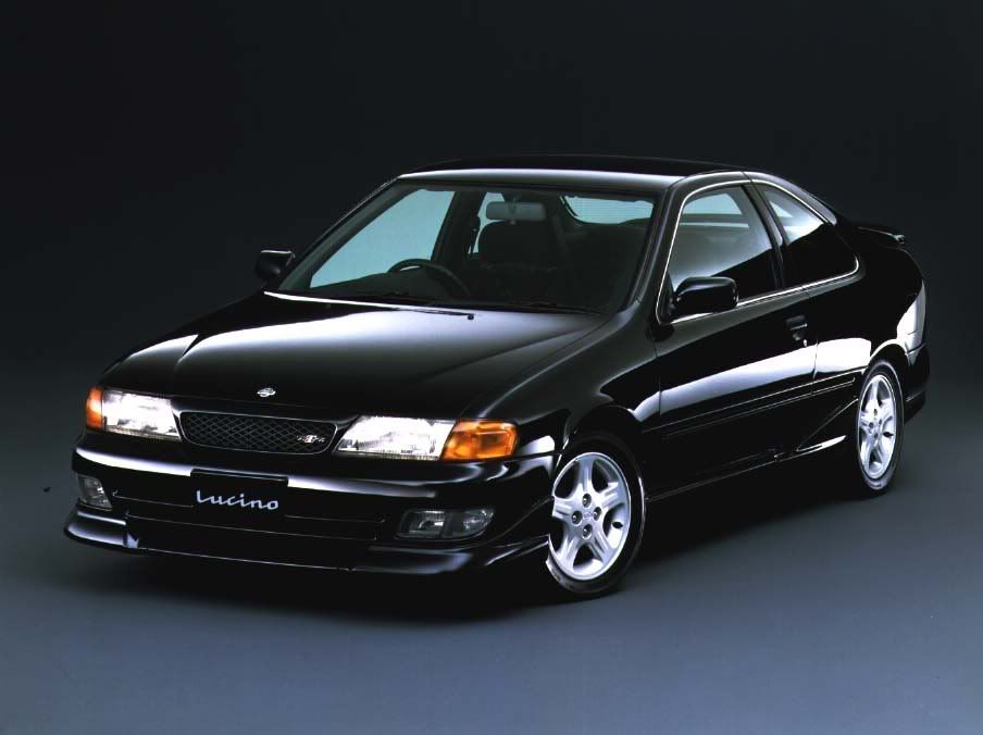

Help me find a set of autech b14 amber corner markers. If you could source us those you would be helping us out ALOT!!
sorry for jacking your thread lawl

I shall have a look around and see if I can't find some of those lights for you if something pops up at local wreckers. Do you want the ones like mine, or the ones which are purely orange?
