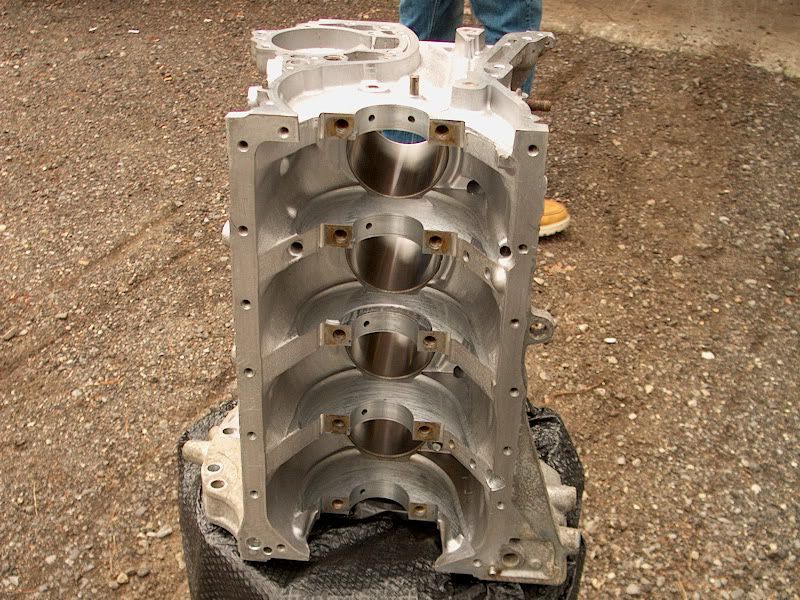

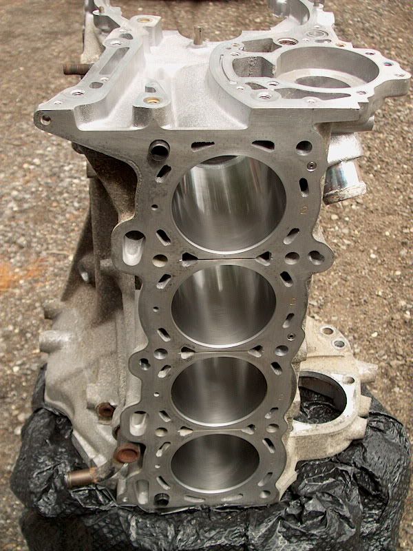

nice clean block back from the machine shop........
nice drill and tap for oil return.......
this i dont get....it looks like they started to clean up the exterior and then changed thier minds?????
either way so far i am satisfied. the guy doing the port match job is now in florida. if only he would quit having fun so i can oh well. i've got my block back and ready to order some parts.....det pistons/rings, bearings, and some ARP bolts should start me off good!

very clean... i would get the rest of the block clean though and replace the freeze plugs

also mike, when they cleaned your block did the exterior come back as dirty as mine? did they replace the freeze plugs and whatnots? it's nothing i cant handle myself, i was just expecting a shiney block inside "and" out.
Mine was the same Leon. They didn't touch the freeze plugs on it but they did take out the oil galley plugs and clean inside the galleys in the motor.
I was thinking about cleaning the exterior of the block like Chris but I'm just to lazy
