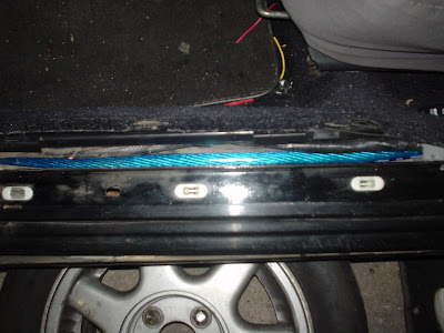

I also have heard that running the thick wire through the inner driver's side door jam can cause issues w/shutting the door? Did you experience anything like that?

You mean here?

You mean here?
Ya, FF to 2:33 on this video I found on the Tube:

Nope, no problem at all. I didn't watch the whole video, but he drilled a hole and ran it through the firewall? FAIL! Through the fender and the factory grommet is the way to go. C
ahhh, he should have read your writeup!
