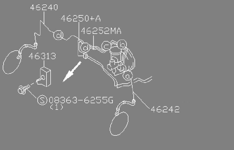

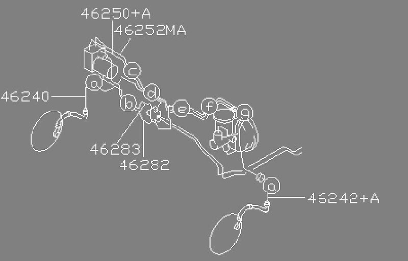

Here are the part numbers and pics to convert a B13 to non-abs. In addition to these parts, you'll need to get a non-abs master cylinder.
Code:
46242      4624265Y00    TUBE ASSY-BRAKE,FRONT LH         $11.48
46252MA    4628364Y00    TUBE ASSY-BRAKE,REAR MSTR CYL     $7.80
46250+A    4628264Y00    TUBE ASSY-BRAKE,FRONT MSTR CYL   $11.62
46240      4624064Y01    TUBE ASSY-BRAKE,FRONT RH         $15.32
46313      4631301E02    CONNECTOR-BRAKE TUBE             $13.43
Conversion is very easy.
  • Remove all the hard lines from the MC, ABS pump & proportioning valve.
  • Unplug the electrical connectors from the ABS pump
  • Remove ABS pump
  • Remove ABS MC
  • Install non-abs MC
  • Install new lines and distribution block
  • Bleed the system
ABS
NON ABS
