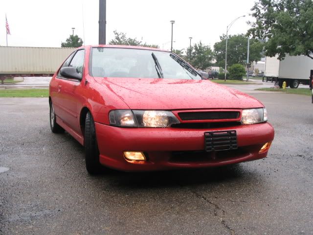

ATTN: This is a B14 200sx... specifically, My B14...
