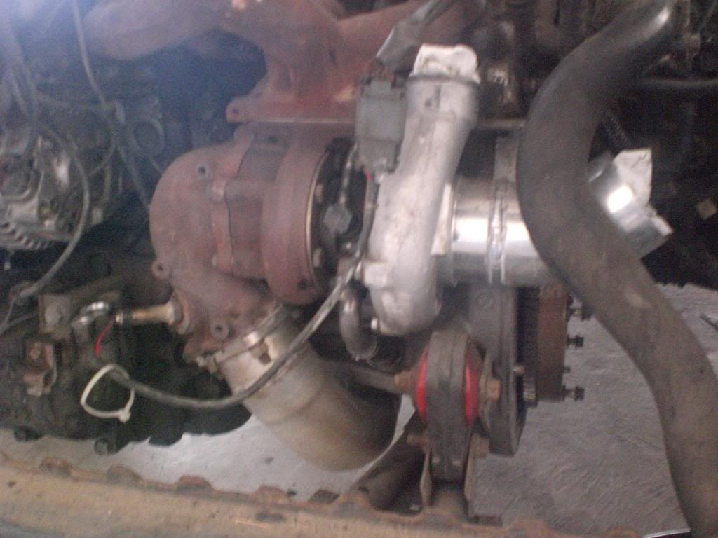

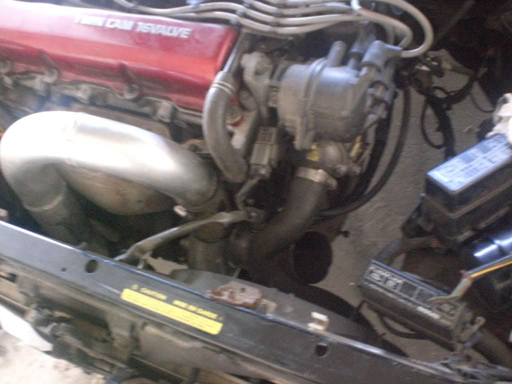

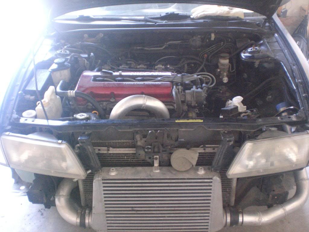

i have a bluebird swap with a gt28rs dp turbo, what im wondering is can the compressor housing be spun so that the discharge outlet is facing down to the ground rather than up b/c i dont really like the look of the big loop of hard pipe sticking up, or is there another option (different manifold..etc)
here are a few pics:
Boost Gets You Laid!
62 Posts
its called clocking
you realize you might have to cut and reweld the inlet extension you welded on
yea thats no problem, thanks for the info wish i had of known about this when the swap was done lol
agent camel toe
9,396 Posts
u might need to upgrade that front motor mount to a dog bone for better clearance
Tunner Pride
240 Posts
ya, clock it. not only is it unattractive, it seems that you would get a little cooler intake temps by rerouteing instead of going over you mani.
