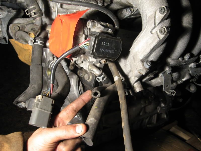

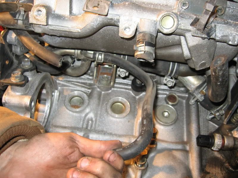

Hey guys I'm almost done with my JDM Swap and I had a question on some what I believe to be water hoses, If anyone knows if I can reroute these or what I should do with them because I dont have another completed JDM to look at input would be great! Thanks -Zeek

Those are for the throttle body. You can either connect them back up, or just use a section of hose and loop them. The US motor has the same connections.

Nice man I think ill just loop'em together Thanks for the info, I figured i could do that in the first place
