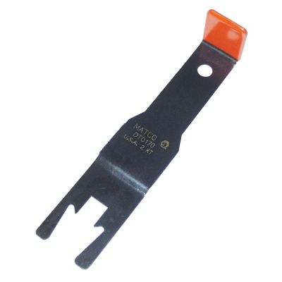

There is actually a tool for this. It's appropriately called a "window crank removal tool." You could also buy a "hook tool" set from Pepboys or Autozone. You then use the small hook to reach around and pull out the clip.
Here are some links:
http://www.matcotools.com/Catalog/toolcatalog.jsp?cattype=T&cat=2221&page=1&#33435
http://buy1.snapon.com/catalog/pro_...group_ID=12078&store=snapon-store&dir=catalog
