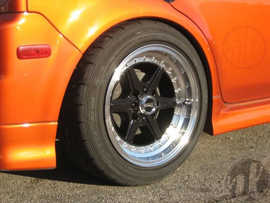

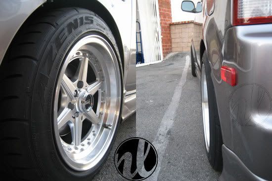

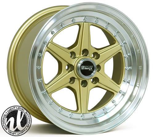

Im on the market for new wheels b4 the summer and finally layed my eye on a set a want........
I want the lip which is the 15x8 +15 offeset.........
The offer a 15x7 but will a tiny 1 1/2 inch lip......the 15x8 is 3.........I really want to hope these work and have no clearence issues..........I got a super deal on em
ill be running a 205/50/15
would i need spacers......I heard u can get em from pepboys for like 5 a pop
ill most likely get em in gold...........

B13 or a B14? Actually, I don't think you'll need spacers with that low of an offset on either of the cars. Your going to have an issue with fender clearance if anything, especially if you plan on lowering the car.
I wouldn't recommend doing this... but that's just my opinion.

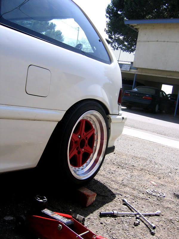

heres my car with 15x8 rota rbs with 35mm offset. i have 205-50-15 falken azenis 615 in them. i have to use a 5mm spacer in the rear to clear the struts. i have my rear fenders rolled and have no rubbing issues. im lowered on hypercoil gen II springs and kyb agx's.

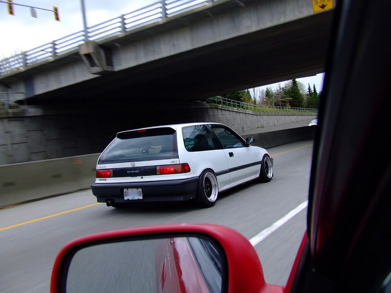

dont judge that the 1st 2 pics of that civic.......those are 16x8's thats why they look so big
