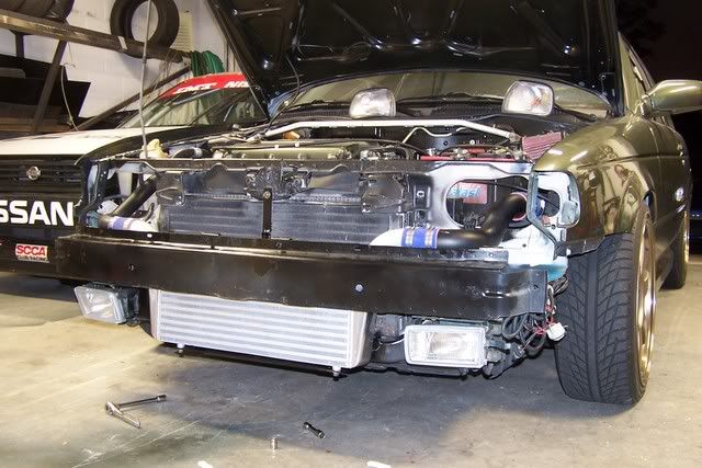

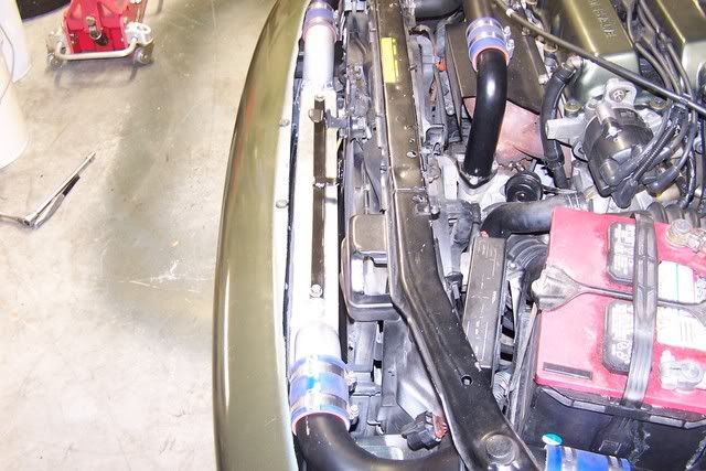

Once it was back in my garage, I had to do some work to it to turn it back into my car. TJ wanted a stealthy look so he hid the intercooler very cleanly behind the bumper. So the first thing I had to do was move that down below the bumper without redoing the clean pipe work that had already been laid out.
Due to TJs clever behind the headlight routing, I was able to keep the fog lights in the bumper by cutting and welding new elbows on the intercooler.

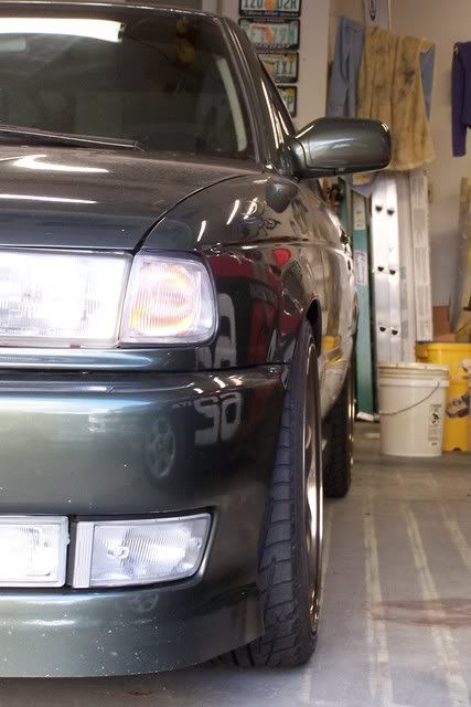

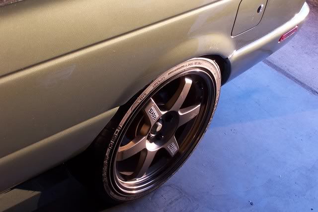

So with that problem solved, I now had another problem. The front track was wider by about 1" yet the rear track had not changed. The B-13 already has a narrower rear track from the factory but now it looked a bit rediculous. You can see it in this pic
Plenty of shadow offset in this pic

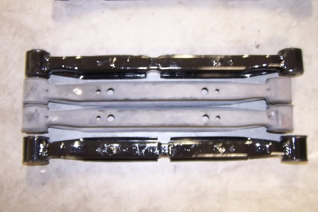

So I decided to extend the rear parallel arms by 3/4". That would push the wheels out and give some negative camber too. Here are the modified vs the stock arms

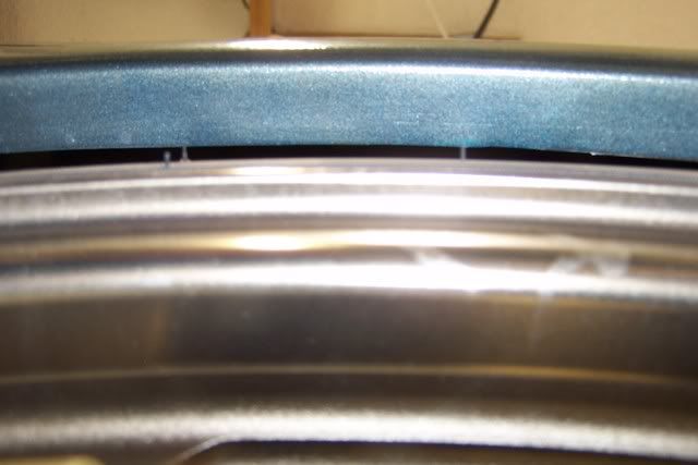

And here is the gap between the wheel and the fender before the modified arms were installed
And here it is after the modified arms were installed
Yes, I had to roll the lip up. But now the rears are pretty close to flush
And the front and rear track are now the same as I have confirmed this when I did my alignment.

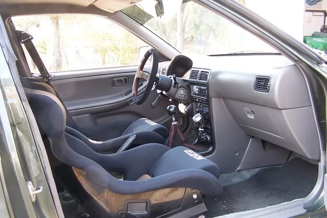

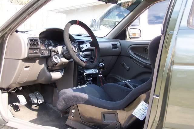

I then had a bit of work to do on the interior. I still had the Sparco Evos from my B-14 so I made some new mounts and installed those. I just got a new 350mm deep dish steering wheel in black suede to replace the old 320mm red Sparco that matched the red B-14 it came out of. Let me tell you, that red wheel was in bad shape and looked like crap in a green car.
