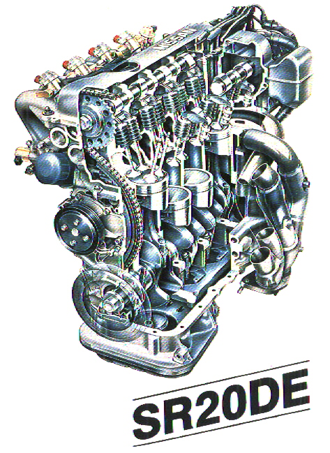

Your timing chain is not going to break. It takes a LOT for someone to manage to do that. The chain is located under the VC on the passenger side of the motor, as you can see in the cutaway pic below:
