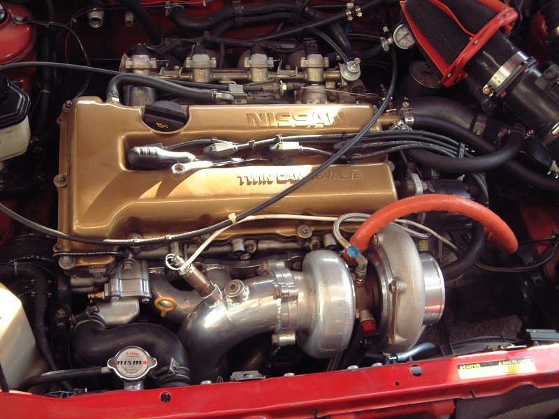

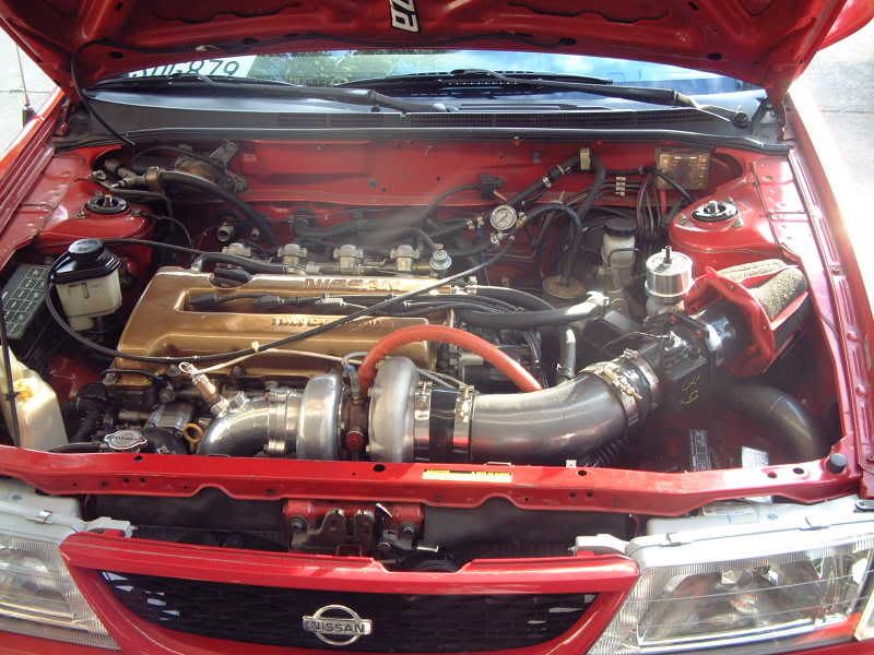

So I decided to get my car ready for the dyno next weeekend. I installed a used Profec B I bought a while back. The car was running just fine before.. I went ahead and did a pressure test before hooking up the Profec. So now.. the car falls flat on it's face when I hit about 7psi (any rpm). The wastegate (Tial 40mm) is set to .8bar (~10psi) and I had no problem running that boost before. The boost controller was turned off during all this. Has anyone ever experienced this? I checked my connections and everything is fine. I did disconnect the MAF for the pressure test.. but everything seems to be ok.. I'm going to uninstall the Profec tomorrow and see if it is the cause. Or if I mucked up something else while I was in there :D

is that lil air filter thing on right? on the line to the profec b?

I'd check to see if all the vacuum lines are connected correctly. Also, make sure the correct ports on the solenoid are used and the last one properly plugged. I've heard of boost leaks at the solenoid, and also of the solenoid going bad itself. But since it does it with the controller off, I'm guessing the vacuum lines are wrong or a leak.

One thing I read time and time again is people forget to remove ALL the plugs from the Profec solenoid. I think there's 3 ports on it, you use two of them, and you have to remove the third one.

It's in, and not leaking. You can't really see it in the pictures. I don't know why the car falls flat on it's face. I figured it would just overboost or run rich (leak).
